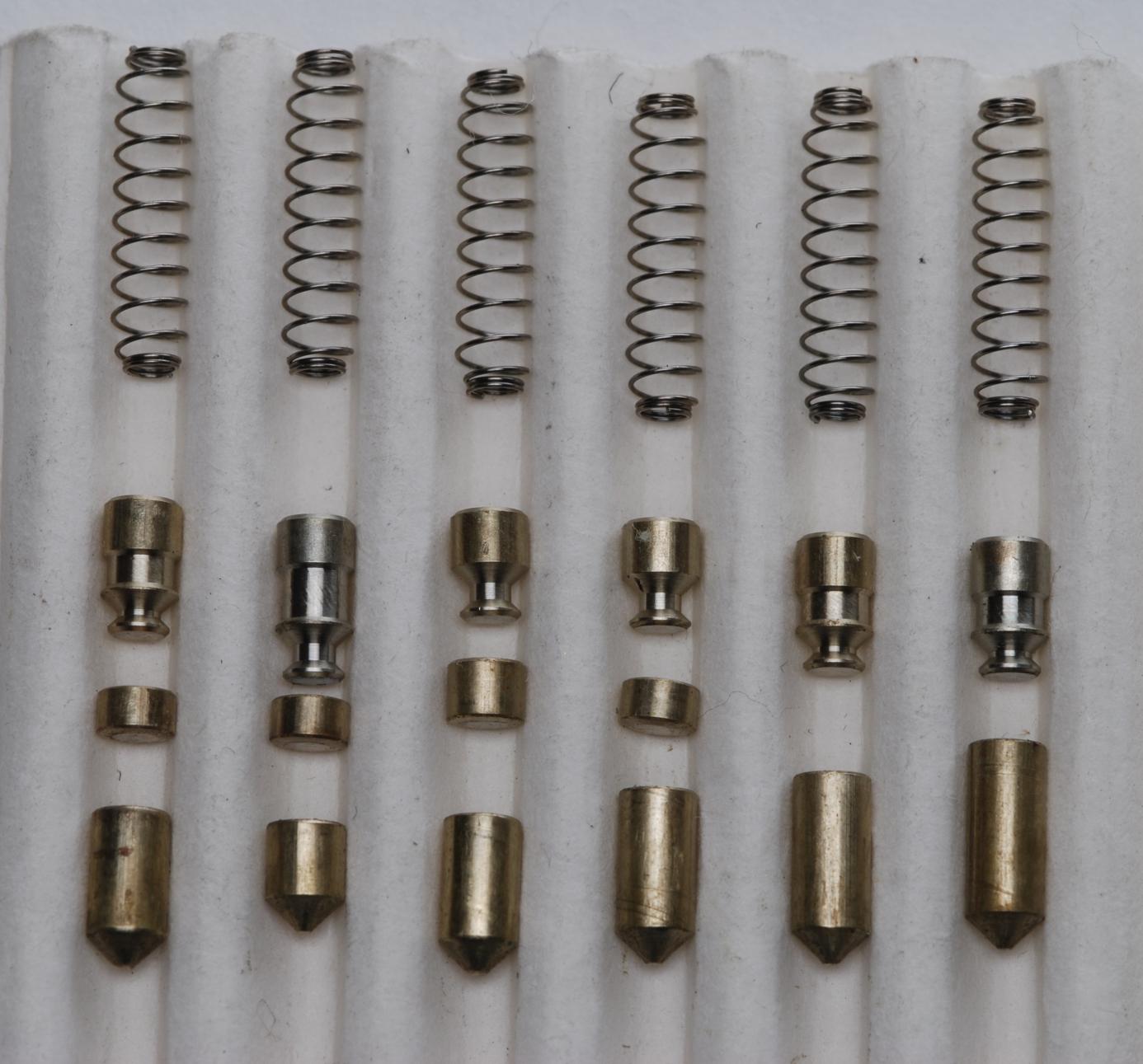

To get some idea of the pins I'm talking about:
First Combi I picked. The new, 'easy' (well... relatively speaking) ones:
These are the pins I call 'double spools' for lack of a better name.
Second Combi I picked. The old bastards (same drivers as ASSA 700):
These are the pins I call "gin bottle" and "mushroom cloud"/"Xmas tree".
Some (atleast older Twin's) only come with the "gin bottle" version of those, i.e. those that only have one lip and not two.
My experience is that with only the 'gin bottle' versions they jam up a lot harder, but behave more predictably.
Like tumbl3r (I think it was) noted way back, these are actually easier to pick when there's a sidebar, as long as binding doesn't alternate between individual top and side pins. The reason is that once the entire sidebar is picked, the pressure from the sidebar springs provide some counter-rotation that helps when working the top pins out of the counter-milling.
When picking the normal ASSA 700, you actually have to provide manual counter-rotation in some cases. See my guide: viewtopic.php?f=88&t=11910
(N.B.: The gut shots are not from my actual locks - my camera isn't that good :) and I have only actually gutted one of them.)
