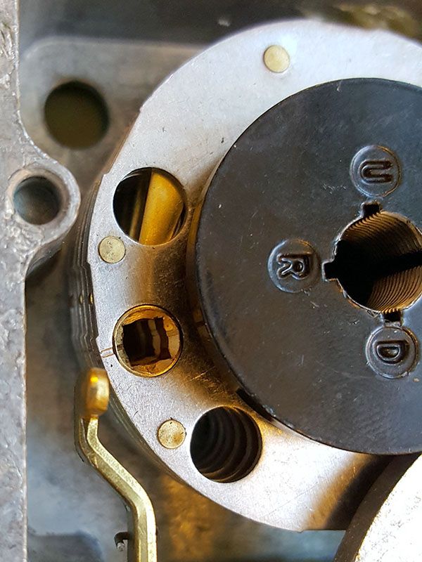

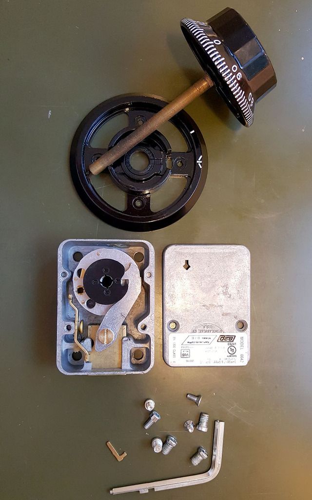

I've been following some of you spinning and started to feel the need of a new toy. Thanks to a fellow member suggestion I got a new one at a good price.
Here are a couple pictures of the false gates, one on the opposite side of the true one, and four others at different angles, opposed to each other. I know There are specific numbers/angles these are located at. I'll make a stand, mount the lock, check them and report here. In the meantime enjoy those pictures. It'll take some time for me to start playing with it.

by jharveee
Nice! What are those little gold nubs in the the middle of the false gate under the change key hole? Do they show up when you graph? Maybe could be used as another landmark to figure where the true gate is?
Re: My New Sargend and Greenleaf 6642
PostPosted: Tue May 30, 2017 8:15 am
by femurat
Good eye! They are on the opposite side of the true gate, so if you happen to notice them in a gate signature ---_._--- instead of ---___--- you know the true gate is 50 numbers apart.
I think they have something to do with the change key hole mechanism. I'll look at them when I get home and let you know.
Cheers :)

by femurat
Is the cam all plastic? I guess they had their good reasons to change the cam material. I would have preferred a brass one. Never mind.
Yes I purchased my lock from the same source, madsamurai. I bought mine after I saw you bought one!
So here are the stickers, it's a 6642-001
And here are the false gates with the spot in the middle in their normal state
Same ares with the change key inserted and rotated, it makes them disappear

by jharveee
So in photo 3 the fence has dropped into Gate 89?
PostPosted: Wed May 31, 2017 7:57 am
by jharveee
Dang, wrong one. 2 maybe.
